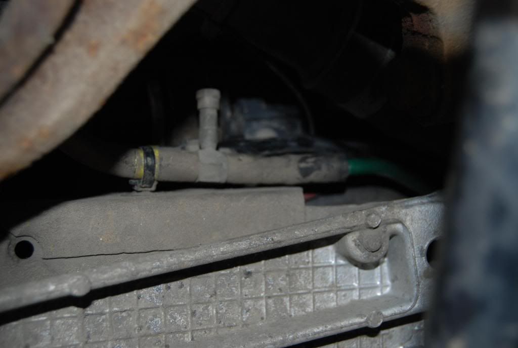

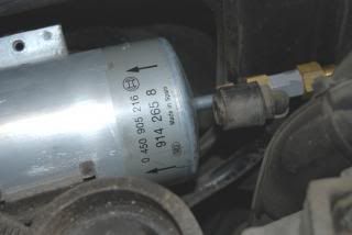

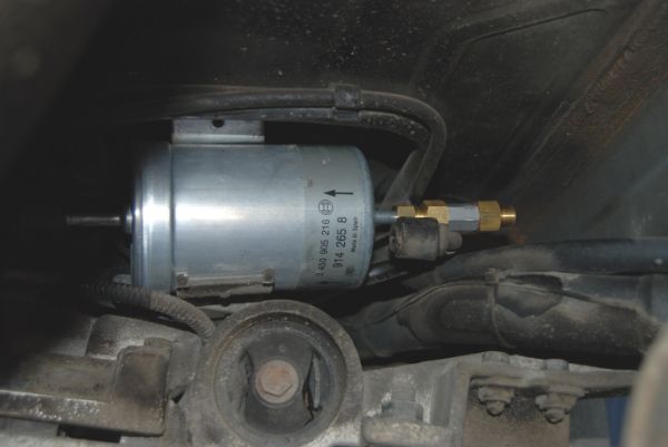

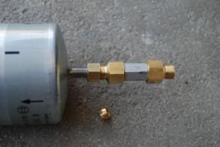

Well today was a failure. On a '99 XC the filter is behind the axle above the subframe. Really could use your expertise on this JRL. I am doing this small write-up so maybe you can stop having to answer this question in the future.
This is how you attach the C/V to the filter. The extra brass washer on the ground is just to show what is used on the filter. I already installed the other one in the picture.
The fuel line attaches to the filter with a 90degree elbow. There is not enough fuel line, from what I can tell, to cut and attach to the back of the C/V. There is enough line if I install it on the front of the filter.
What is this valve with a cap in it attached to the green hard line. This looks the the only place the C/V could go if I want it behind the filter. The picture is looking up from under the control arm in the rear passenger side. On the left is where the line goes up to the filter. There is maybe 7" of line before the 90degree elbow.
JRL or anyone who has done this on a '99 or 2000 AWD, is there much difference in installing the C/V in front of the filter? Will the fuel drain out of the filter if it is in front? Is that why you install it behind the filter?

I installed mine where that schraeder valve is in the wheel well. Worked just fine.

How many miles ago did you install the CV.
How is the hose secured to the green hard line? I don't see any clamps. I also have never dealt with fuel hose with a nylon hose inside rubber. Does the nylon inner hose fit inside the green hard line and I just carefully cut away the rubber hose?

I would do it on the left of the schraeder valve actually, that side might not use the nylon-under-rubber type hose.
On my car, I completely got rid of the metal line and ran a new fuel hose from the valve. (Had the subframe down, you won't need to do this)
But honestly, I have no idea if the hose going to the fuel filter has the inner plastic sheath or not. :-( Sorry!
